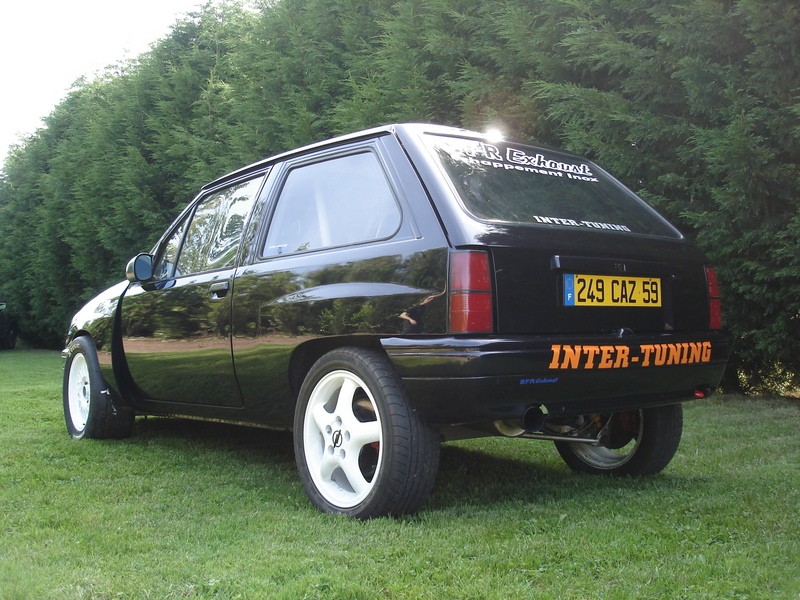

This car is not from Belgia ?
Re: Bonjour from Germany
Message par GTdriverr le Dim 21 Oct - 0:31
Noo! Why belgia??
GTdriverr
Messages : 299
Date d'inscription : 06/06/2012
Age : 39
Localisation : Germany
Message par JeY77 le Dim 21 Oct - 0:38
Because a friend has a friend from Belgia who have a blue GT, with big preparation. He plays with an other friend who have this :
Corsa A with Calibra engine (modified in Bi-turbo), AWD of Calibra, ... Very Happy
Message par GTdriverr le Dim 21 Oct - 0:59
No, this car is from Greece!
The Corsa looks ace, mate!! Excellent work!
Btw. from Belgia i know bartike (bart) who has a highly modified PGT Twisted Evil
